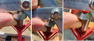

Less often measured and referred to is the Wing Edge Angle, not to be confused with the wing sweep or relief angle. This is an important angle as it determines how the gouge performs when the wings of the gouge are cutting. Unlike the above two angles, this angle is not measured in reference to the axis of the gouge, but between the side of the flute and the wing bevel…
Halfway along the wing edge is a good point for measuring the average Wing Edge Angle. When measuring the nose bevel angle we view the gouge at right angles to the shaft tip to get an accurate reading. Viewing the Wing Edge Angle is more of a challenge. We have to take an imaginary slice at right angles through the wing edge at about the midpoint like this…
The wing edge angle is then viewed as if the tip on the end of the gouge has been removed at that imaginary slice line. By looking square end-on at that imaginary slice we can accurately see the Wing Edge Angle.
Unfortunately most swing arm protractor won’t fit into the flute to measure that angle, in which case some interim steps have to be taken to transfer the wing edge angle to a protractor. I use a piece of stiff card inclined at a right angle to the wing edge along the imaginary slice line. The side view looks like this …
Something like Blu-Tack can hold the card at that correct angle in relation to the wing edge while finding the Wing Edge Angle. With the card held at that right angle to the wing edge, cut out a recess in the card to match the wing edge profile.
By extending the wing edge angle lines you can then measure those on a protractor.
In this case we are looking at the wing edge angle on a 40/40 grind, which as it happens also has a 40° wing edge angle. So, what you have in fact is a 40/40/40° grind; 40° nose bevel angle/ 40° wing relief angle/ and 40° wing edge angle. In almost all other cases the wing edge angle has to be measured in the above way to know what it is.
For example, the bowl gouge in the following post has a nose angle of 55° has a wing edge angle of 62.5°…

The wing edge angle can also be measured using a protractor - see the image below. Simply divide the measured angle by 2. (demo only - not an actual measurement)

It is not clear to me at this stage how you have used your protractor to measure and calculate the wing edge angle, but it may be clearer to me when I try to measure that way myself.
So I gave Doug's method a ago. I set my protractor at twice the known wing edge angle for the following gouges, but couldn't find any correlation to that angle myself. Here are the photos with the protractor set at twice the known wing edge angle...
