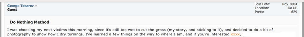

Of course it was NOT Michael Mouse Donna, or Reality Check or what other name he used later, his name is George Tokarev, and is from the UP in Michigan, I got a post of him from before.
