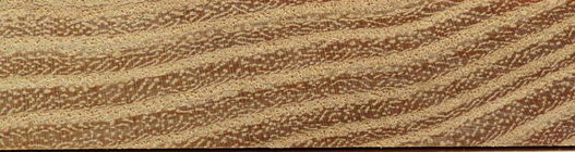

Karl, you may have pushed me in the right direction. I just looked up ash varieties, and suspect it may be black ash. The bark looks similar, and I found this picture of the pores on the Wood Database, which looks very similar. View attachment 50296
I have more black ash on my 5 acres then any other tree and none of them has bark like that one

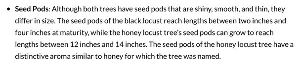

Wild honey locust has long thorns on it, like 10+ inches long, and big long seed pods, and the seeds look like Milk Duds candy. There is a domesticated variety, Moraine locust which gets a lot bigger and doesn't have all the nasty thorns on it. I do think this looks like black locust. Makes excellent split rail fence posts and rails. Very rot resistant.
Honey Locust is not related to Black Locust, they are different species.

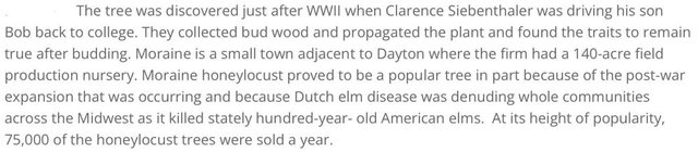

The thornless Honey locust is a ("sport") and was discovered by a little town called Moraine, the person that recognized it cut budwood from the tree and grew it, then got a patent on it (Why ???) anyway they did grow and sell the saplings all over, of course others found ('sports also") just one street over where I lived in London Ontario, there was a thornless Honey Locust that had the seed pots on them, big long twisted pods where most that did not have the thorns also did not have seedpods.
The Honey locust seedpods are eaten, kind of sweet, the Black Locust seedpods are poisonous.
The Black Locust seedpods are jus 4 inches or so, the Honey Locust seedpods grow up to a foot long and are twisted, picture here.
