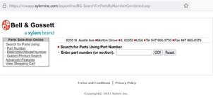

When I searched on the internet I came across the webpage below. I appears that the company is still in business in the same town. They are part of a larger enterprise Xylem. I wish you good luck in your search.

Thanks Jim. Unfortunately none of the data on the motor label seem to lead to any useful info.
