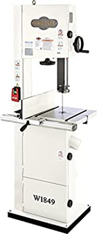

I'm also looking at the 14" 2hp resaw w1849. Not as much width capacity, but 14" height, instead of the 12" with the 19" shop fox. This might be a bit better for processing larger burl caps.
