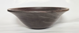

Here's a walnut bowl I made after the demo, about 11" diameter, 3.5" high. I didn't have a press, so just used weights from an unused barbell for the glue up. I drew a reference line on the board before cutting the rings which helped with lining things up for the glue up.

An eye opener for me was when he used different angles for different rings - shallower near the outside, steeper near the center. That allows making a more natural, curved profile than I had seen in other BfaB's that were made with single angle like with a Ring Master for example.
I’ve started doing this too. Different combinations of angles can create concave or convex sides or combinations of them both as you said.
I picked up most of these ideas from ThePapa1947’s YouTube channel. He talks about combining angles to create different wall profiles.
Very nice!
