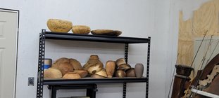

I don’t turn oak so I can’t comment on that. I have lost bowls using the paper bag method. Now I rough turn, wax inside and out and set them on a shelf for a year and they are ready to finish turn. I haven’t lost a bowl yet doing it that way. A year seems like a long time but goes faster than you think. Around half of the bowls on this shelf are ready to finish turn.013B1F84-52CE-4846-BCE4-C24C36700AC1.jpeg

I don’t turn oak so I can’t comment on that. I have lost bowls using the paper bag method. Now I rough turn, wax inside and out and set them on a shelf for a year and they are ready to finish turn. I haven’t lost a bowl yet doing it that way. A year seems like a long time but goes faster than you think. Around half of the bowls on this shelf are ready to finish turn.View attachment 52764
I smell a ready to turn shelf pics thread!

My goal is to get a couple dozen on the shelf drying. I have 3 now, all elm which doesn’t seem to crack no matter what I do. Interlocking grain and came down in dead of winter.
