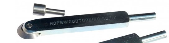

I noticed in Andy Phillip's YouTube videos that he frequently used a unique carbide tool. The blade was set at a 45 degrees angle to the shaft. I wanted a tool that would present to the wood at an angle but was not do subject to rolling as the tools that have the blade mounted horizontally. I grabbed the manufacturer's name off the shaft in one video and chased around until I found HopeWoodturning.co.uk - a UK manufacturer. I could not find a domestic reseller so I tried to place an order direct with Hope website. When I tried to pay I got a message that they do not ship to the US or Canada. I finally found a Canadian supplier, Black Forest Woods Company and was able to buy the tool I first saw in Andy's videos. I love it!
Now I see another UK wood turner using another unique tool........by Hope Woodturning! Same deal - can't find a reseller, Hope still won't ship to US and Black Forest Woods carries a very limited variety of Hope tools, not including the one I want - the Negative Rake Bowl Scraper - WITH THE CUTTER MOUNTED FROM THE UNDERSIDE OF THE TOOL - cutter is 48 mm wide. Big, wide, flat blade that is very stable in use.
I have attached a couple of photos - hard to get just the right ones but they may help clarify my description of the tools!
I REALLY want this tool! Does anyone know of a supplier - US, Canadian or some other source that will ship to the US?

Thanks Peter. I'll take a look at that one although it is a full round cutter of larger than common diameter that I really want. Particularly for its use on interior surfaces.
I sent an inquiry to Hope Woodturning and got a prompt reply from Simon Hope confirming that some insurance regulation prevents him from shipping to the US and Canada. He suggested two suppliers:
Please see, https://www.breezewoodturning.com
or in Canada www.blackforestwood.com
Breezewood was a new possibility for me and I checked their website. They are UK based. The cost of shipping ($65) was nearly as much as the tool ($95). A little rich for my blood.

I want to thank each of you who has responded to this post. I don't think I was very clear about what appeals to me about this particular scraper.
My modest experience with carbide tools poses two challenges.
The first is to keep the tool rock steady on the rest while cutting. I own several larger scrapers but they either put a round section on the rest or they do not have a very wide base - mine are in the 1/2" to 3/4" range. I just haven't developed the skill to avoid having those cutters twist/catch occasionally with unfortunate results. So I would like to have at least a 1", flat contact with the tool rest.
The second challenge is to get a smooth cut through a long arc. Using the smaller diameter cutters I often leave ridges :( - the Hope cutter is nearly 2" in diameter. Watching it in use it seems to offer the same long engagement that many wide HSS scrapers offer.
Have I been honest enough? This is as much about my experience as it is about any inherent property of a particular tool.
Once again, thanks to those who offered tools that might do the job for me.

Thanks. I looked at those. I have lots of respect for Simon. Those scraper blades are high speed steel. I was hoping for carbide. I don't think the carbide will hold a burr. Not sure whether that would be disappointing. Turns out that the shipping cost from Breezewood doesn't seem to go up if I order an additional tool. Might try doing that to spread the cost of shipping over a couple of items. Even just ordering 1 more tool cuts the per tool shipping cost from $65 to $32.50.

Oh Dear! How I hate the taste of humble pie!!!!!!! The more I look into this, the more I learn. Turns out the Simon Hope cutter is NOT carbide. I just watched a good video from Simon Hope on sharpening and he is emphasizing the raising of the burr. Sigh! I have been in touch with Breeze Woodturning in England and they can supply just the cutter for about $45 including shipping. I can easily mount the cutter on either an existing tool with a big flat or just make something up from bar stock.
