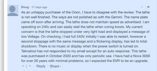

I've owned the Orion for a couple of months now. Overall I really like it. I'm still pretty far down the woodturning learning curve but have had a chance to turn a dozen or so bowls, some spindles, and few dozen pens with my kids. I initially had some QA and finish problems caused by poor packaging in China but I have found Teknatool very response. I definitely have the sense they want to make things right. With those problems fixed, the machine is smooth and quiet. I choose the Orion primary because of its compact footprint and capabilities at the price point. It's never stalled on me despite making many bad beginner mistakes (big catches, way to aggressive coring cuts, etc). The controls with the dial to change speed (twist for 10rpm; push and twist for 50rpm), 8 presets, and big red button are all easy to use. By contrast a friend has been teaching me on his 3 HP Oneway 2436. The Orion is not that lathe but nor do I have the room for that machine. Lastly wrt to an outrigger, Teknatool is selling the outrigger for the older 2024 for the Orion (and on sale at 50% off). I purchased it and bolted on my lathe but ultimately returned it. While it will work, it was clearly not designed for the Orion so the fit wasn't quite right. I can only hope Teknatool will sell a bespoke Orion outrigger.

Unfortunately I sold my Nova Comet lathe looked to “upgrade” to the Orion wood lathe. I purchased the Orion in November 2020, after my electrician upgraded our electrical panel box installing a dedicated 20 amp circuit and surge suppressor I was able to begin use in January 2021 Four months following the HMI circuit board began to malfunction. It eventually completely stopped functioning. I called Teknatool, sent emails and finally wrote to their headquarters in Clearwater, Florida. They finally responded saying they don’t have a replacement for the HMI circuit board, but could mail a used part. Having no alternative I accepted their offer. As of this date January 8, 2022 they still don’t have a new circuit board in stock. For the past few months I began having same issues with circuit board. When not in use I always disconnect power cords from all equipment, any day I expect it will completely stop working again. In late fall the quill in the tail stock began having problems opening and retracting, it eventually stopped, I called, emailed and no response from Teknatool. I took the tailstock to a machine shop and at my expense they repaired it. The bolt that attaches to the hand wheel moving the quill had broken, probably a $3.00 part? Anyway Teknatool advised me they do NOT have this bolt in stock and do not know when it will be available, I went to a hardware store and making it work until Teknatool can find this bolt.
It is for these reasons at this time I cannot provide a satisfactory rating for the Orion and/or Teknatool.
