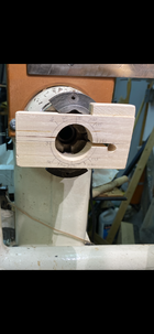

At the headstock end you could adapt Jim Duxbury‘s Dux Chuck and mount the base in it to match the tailstock offset. There are a couple of You Tube Videos on it, an original from about a year ago by Jim and one of the most recent by Mike Peace.
