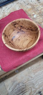

I’ve found that it moves just like most other woods do. If you’re starting from green, and you want a perfectly round hollowform, you’ll have to twice turn (at least the exterior). Here is a small hollowform I once- turned semi-green. You can see a little bit of movement occurred when drying. The first pic, the right vessel is a gourd. Lol.
