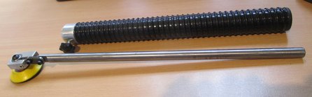

I am very familiar with this set up its well known down under and widely used. Although prefer the inertia sander with 40mm Velcro sanding head on a universal swivel head the spins on a couple of skateboard bearings. I can extend it outof the handle up to around 400mm this is about as far as I like to go
