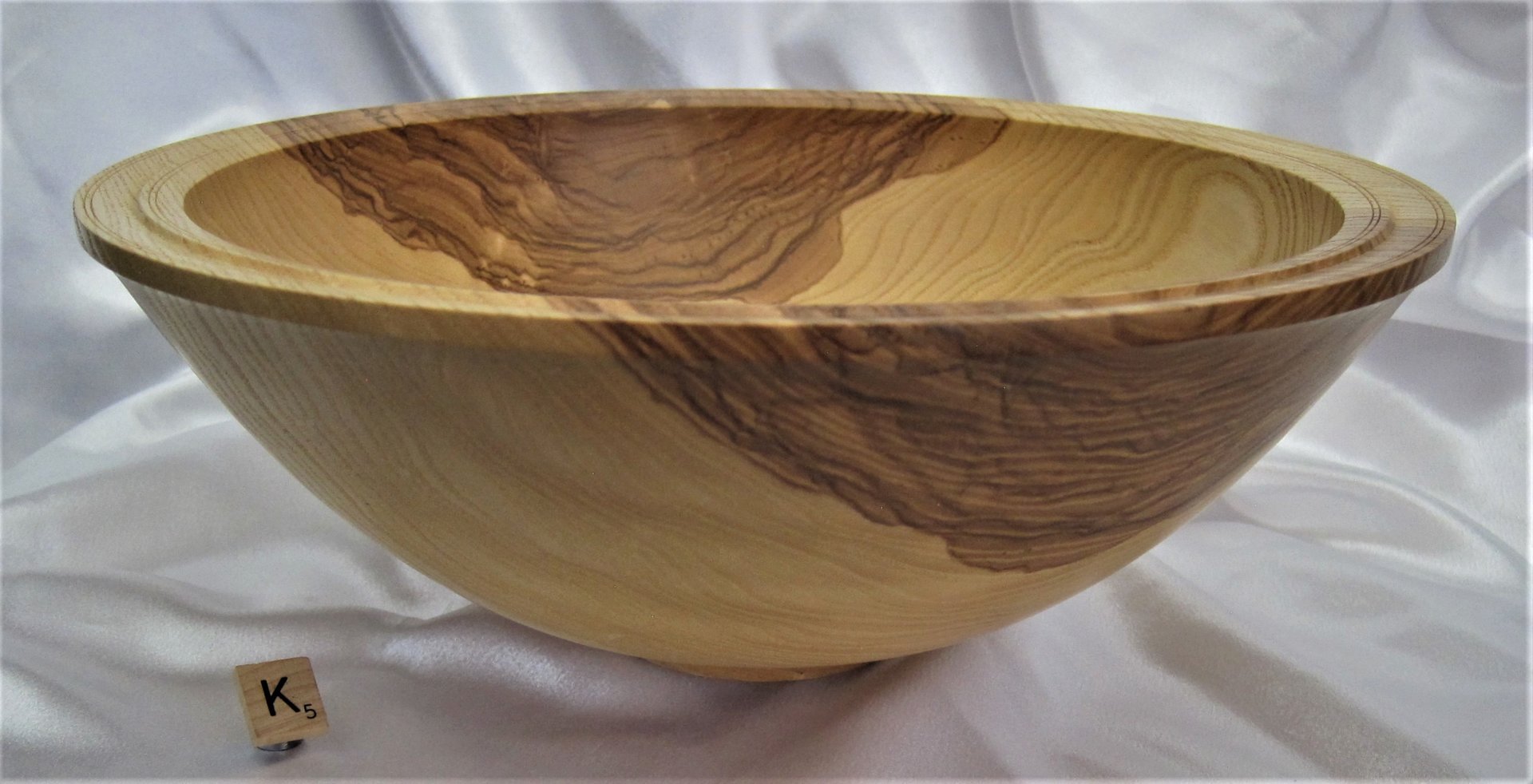

BTW, all of the bowls on my Etsy site, and many of those listed in my AAW album have the actual weight listed. As you can see, my bowls are far from being what anyone would describe as being "heavy", even though they are not thin wall. This large 13" x 5" ash salad bowl is thick wall. It's about 1/2" all the way, IIRC, and it weighs 2 lb 12.4 oz.....far from the 20lb bowl you referenced, and quite easily handled.....even for Sam's sister! :) (99% of my not-thin wall bowls are much lighter than this one.)
