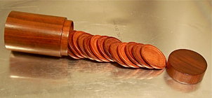

Here are some that I turned before and brought along in 1967 when I came to Canada, so better than 56 years ago.
An Afzelia box with a bunch of coasters., edit, actually the box is not Afzelia, but the coasters are, I forget what the wood for the box was :oops:
A two shelf Teak turning with a Stainless Steel tapered shaft and brass covered ball bearing ball.
A Teak and Padoek candle holder.
I turned many more pieces, everyone in my wife's and my family did get at least one turning, as well as my friends, though I have no pictures of them :-(
