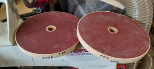

I made a few of these for the lathe and they are awesome. I used the beal 1.25-8 tap so I can quick change them and I put grit on both sides. The dust collection is already in the right place too.

Do the threads work good in I'm guessing mdf?
That's a good idea making them double faced.
Threads are indeed MDF, but I soak them in CA 2P-10 and keep making passes each day with the tap, then CA till they are stone hard. they spin on like a track bike front wheel. I started them on the huge oneway cole jaw equivalent and thin/flatten them out once the threads are solid so I don't get the equivalent of a wobble dado.
Once the sandpaper fouls out (I use the eraser brick and they are doing excellent even after sanding some gross stuff) I just toss the disc and make another one. I find that trying to true up a second batch of discs takes less time than re-truing one after I pull the PSA off. Even with heat, they get too thin and the headstock threads begin crossing over to the sanding side of the disc.
