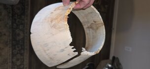

I've been thinking about making a lampshade for a while. I am still a rookie on the lathe, been turning about 9 months. But being in Colorado I have plenty of access to aspen and that is one of the best woods for lampshades so I really want to learn how to do it. I felt ready for a challenge, and jumped in.
Screwed a faceplate to log. Mount log to Jet 1640. Add tailstock support. Attach it with bowl gauge, rough out, start fine tuning with roughing spindle gauge. In my pea-brained mind (and having never done this before), I was going to make the lampshade with the right side of the log, and part it off the rest of the log attached to the headstock when it was done.
I think that was mistake #1. In the future I will chainsaw-rough out a "cone" that will be the rough shape of the lampshade, and...... I don't know. Waste block? Open to suggestions.
Shaped the outside, removed as much wood as I could. Started on the inside. Mistake #2! Looking back I am embarrassed, but I just planned on the end of the log being the bottom, wide end of the shade. Hey, cracks and all! SMH. Should have sliced off cookies with the chainsaw until I hit clean wood. The cracks kept me from really getting the bottom 1/3rd as thin as the rest.
Mistake #3. I do not own a pair of calipers. I will own a pair of calipers by suppertime today via Amazon. Pretty much REQUIRED for this project. There is no way to comprehend a 16th of an inch 8 inches down a shade by pointing 2 fingers at eachother from inside and outside. LOL.
So, sand the outside to 240. Screw the inside. At this point I knew this was a prototype. Call the wife out catch the shade as I parted it off. We both fail. Equally. And spectacularly. Project over, hahaha.
So next time: Cut off ends of logs and get to clean wood. Prep a blemish free "cone". Own and use calipers. Still contemplating how to part off the top of the shade.
Suggestions welcome, and don't be like me.

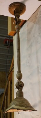

The pendent lamp is made of white oak turned to about .03" wall thickness.

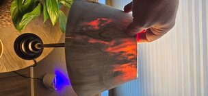

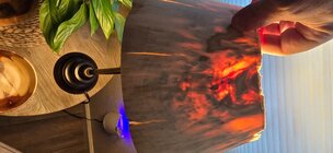

Here are some photos of my second lampshade attempt. It is too thin and cracked when I forced the scraper, but at least it shows some of the process. I carried it through to practice all the steps even though it's destined for the wall of shame.
The first picture shows the effect of uneven thickness with a dark band near the top. The second shows how sanding the outside (at center) makes the minor dark lines disappear.
