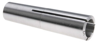

Another holding methodP #2 morse taper collets. Although the ER collets can be used with a variety of tenon diameters, the collet chuck and the individual collets can be expensive. MT collets are quite inexpensive! I've bought sets and individual collets from Little Machine Shop, Amazon, and elsewhere.
Here's an example. The collet does need a drawbar to hold it tightly into the headstock AND squeeze the work firmly. Drawbars are easily made.
Besides having to use a drawbar, the disadvantage is needing to turn a 1/2" tenon on the end first. However, the holding is tight and the piece can be removed and remounted with perfect registration. No tail stock support is needed for short spindles such as finials.
These finials, holly and ebony, have 1/2" tenons.
The collets are cheap, threaded for a 3/8x16 drawbar. I buy them by a set that included from 1/8" to 1/2".
