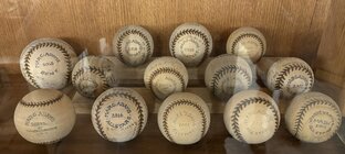

I’m taking another class at MASW this week, this time with Michael Kehs as the instructor. During a break I wandered up front and took a photo of the display case with the baseballs Michael Hosuluk turned over the years, as evidence of my earlier claim.
