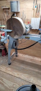

It depends what features you are looking for. I have a lot of neck and spine problems. A lathe with a pivoting headstock is a must for me. I also wanted a lathe with a remote pendant so I could keep the controls with me and not have to reach around a large spinning bowl. I bought the Record Power Envoy and it has been the perfect lathe for me. It will turn 16” over the bed and 39“ outboard. It cost around $2,000. The also make the Regent which is 18” over the bed and 39” outboard for around $2,500.
F0BE09F2-2D16-4028-84ED-F36718602871.jpegB965DB1C-7FCD-42C2-8612-899069861D93.jpeg8F089590-23AB-451A-95C1-2178C7539A67.jpeg
View attachment 52044View attachment 52045View attachment 52046
