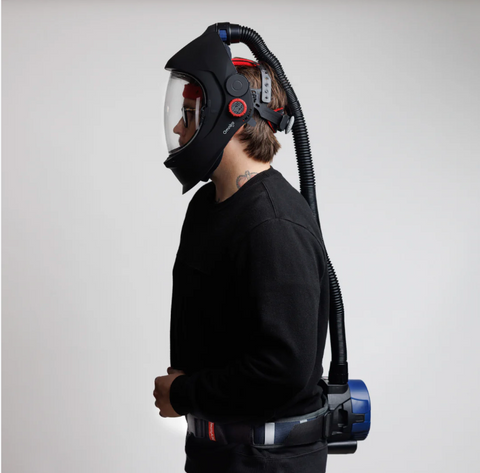

Here are your choices
Many of us have the Trend Airshield, the Trend Airshield Pro, or the Triton Powered Respirator. (I have the Triton and prefer it to the Trend.) These are "consumer" level products and may not be what you need. They are not rated for anything more than "nuisance" dust and cannot be equipped with filters that work with organic fumes (paint/lacquer). Their batteries cannot go for a full 8 hour day.
However, you can overcome the battery issue by having an extra battery pack and these consumer models are much better than just a dust mask. Depending on how much faith you put on ratings, you may or may not believe they are better than a half-mask respirator. I think they are. The positive pressure design should keep particulates out of your eyes, nose, and mouth. The only question is whether the filter does the job of getting rid of the particulates. Since Triton's Powered Respirator uses the same type filters that are used with half-mask respirators, I think the air inside the Powered Respirator should be at least as clean as what you'd get breathing through a half-mask. (That's not necessarily true. The fan of the respirator might force the particulates through the filter rather than allowing the particulates to be trapped by the filter.) At any rate, testing is expensive and Trend and Triton haven't paid to have their products certified, so they cannot be rated for more than nuisance dust protection.
Your other options are professional grade powered respirators (PAPR). 3M makes several PAPR models. The two that seem to be best suited to woodturning are the Airstream and the Breathe Easy 1 System. Both come with (what appears to be) the same helmet and face shield. The difference is the Airstream has the fan and filter located in the helmet while the Breathe Easy's fan and filter are belt mounted (the air is pushed up to the helmet through a flexible hose). This difference is more than one of where would you prefer to carry the weight of the fan and filter. The Airstream uses a custom HEPA filter. The Breathe Easy uses standard filter canisters -- giving it the flexibility to be used for both particulates and organic vapors.
So, the Airstream allows you a little more convenience -- it's easier to take on and off, you don't have a tube connected to the helmet, etc. It also costs a bit less than the Breathe Easy. On the other hand, the Breathe Easy should be more comfortable to wear since the weight of the fan and filter will be on your belt and not supported by your neck. In addition, if you buy the right filters, you can use the Breathe Easy when sanding AND when spraying paint or lacquer.

Well, it's expensive, but you can't do better than the 3M Airstream. I bought mine at Airware America and like It is industrial duty and approved by MSHA and NIOSH. It comes with a HEPA filter, has an airflow of approximately 10 CFM, is comfortable, and relatively lightweight at less than two pounds. The battery hangs on your belt which is good because it weighs over a pound. Having the battery separate keeps the helmet relatively lightweight. The helmet can also be used with ear muff hearing protectors if you are working in a noisy environment such as using a chainsaw. The cost of a replacement battery has gotten to be really expensive, but the good news is that they last a very long time. Mine is about six years old and still going strong. You can run the unit all day long without the need to recharge the battery. Sometimes I go for several days before recharging the battery. You could probably rig up your own battery pack for a lot less money, the thing that make the battery so expensive is that it is certified to be intrinsically safe for use in explosive atmospheres such as in a coal mine. Not many woodturners need to worry about using a battery that is rated intrinsically safe.
If I turn any kind of dry wood without using my Airstream, I will develop a major URI. When I am wearing the Airstream, it does such a good job of filtering that I can't even smell the wood that I am turning. Sanding used to be especially tough for me, but it is no problem with the Airstream.

I have some basis for comparison.
I didn't like the Triton because the units I used/tried all had some distortion in the visor that I just couldn't get past.
The Trend AirShield Pro is (in my opinion) the best bang for the buck. I used one for two years. It's well constructed, and the company's service is first rate.
Currently I have three different configurations that my wife and I share.
• A 3M Breathe Easy helmet with waist mounted blower/filter/battery. The nice thing about this rig is that I can swap in organic filters instead of particulate filters.
• A 3M Breathe Easy helmet that's tethered by a hose to a wall mounted HEPA room filter. This is a sweet setup, low weight, and very quiet because the fan is a few feet away
• A 3M AirStream helmet (with self contained fan/filter). I've just completed hooking up a small LiOn battery to it... very very pleased because the battery is inexpensive, only weighs 4.5oz and runs for 9 hours, and I'm experimenting with mounting this lightweight battery on the top or rear of the helmet, making it self contained, like the Trend.
So I've got some good toys, each configuration has its strengths. Fortunately, through some diligent searching, I've gotten very good deals on these items... nothing was retail <vbg>
Another pretty new item is one I haven't tried, but looks very good: the 3M VersaFlo. It has a lightweight, compact belt mounted fan/filter. The helmet is lighter than the other units (there are two styles) and it uses a LiOn battery. It can take particle or organic filters. I don't know anyone who has one, but I really like the design.

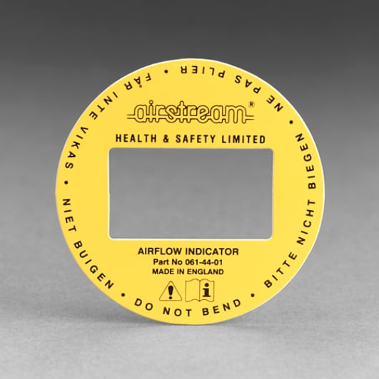

First of all, a GO / NO-GO tester of any sort is not a measuring device to give a specific readout of the parameter being tested. This type of tester is a simple device that does not require making a measurement and comparing it to a performance requirement -- it just simply, as the name says, a device that tells the user if the condition is GO or NO-GO.
The principle is no different than it is for the BreatheEasy tube and ball tester. If the pressure differential is sufficient to hold the indicator on the intake then that is a pass condition for the GO / NO-GO test. If the pressure differential is not sufficient to hold the tester, then that is obviously a NO-GO condition for meeting the spec flow rate.
Because of the design differences between the two units, the devices are necessarily different. Although woodturners are free to ignore the filter condition and use them as long as they please, MSHA and other industrial users requires checking the airflow before donning the equipment as a matter of standard safety operating procedures.

You are correct that the guaranteed minimum performance spec for air flow is 6 CFM. The 10 CFM comes from what is advertized, which presumably means the ideal performance attainable with a battery in perfect condition and brand new filters. This sort of implies that the value of 6 CFM is the minimum flow rate that will keep the indicator in place and with anything less, it would not hold (for those who are not familiar with the Airstream, the indicator that Alan shows is placed at the air intake with the prefilter removed -- the pressure difference will hold the indicator in place if the airflow is satisfactory -- otherwise, the indicator will not stay put).
I suspect that most of the consumer grade powered respirators are stating the ideal airflow for their units and not a guaranteed minimum. If that is the case, it seems most equitable to apply the same criteria to all units when making a comparison. I imagine on "Day One" my unit may have been able to provide 10 CFM, but I have no doubt that with a six year old battery and a filter with a couple hundred hours of sucking up dust that it is somewhere between the peak value and the guaranteed minimum.
Look about 2/3rds down the page on this link to the Airstream at Airware America where airflow is stated as 10 CFM with the AS-115 motor assembly. Before about 2005, the previous assembly had a maximum airflow of about 8 CFM. Older units can still be upgraded by getting the newer assembly. Also, about the same time, the battery was improved to maintain a constant output voltage along with an exended run time between charges.

Here is a set of 3M videos on the Airstream covering just about all that you might want to know. I believe that it is video #3 that talks about not cleaning the the HEPA filter. I initially considered cleaning my filter, but then I learned that cleaning damages the sensitive membrane on any HEPA filter. Since I paid really big bucks to have really clean air, I could not rationalize that with using a recycled and degraded filter that does not perform as well under the guise of being economical. I said to myself, "there's something wrong with this picture".

Have a look at the CleanAir HEPA PAPR from Peke Safety Supply. I find it comfortable, and can turn all day on a full charge.
