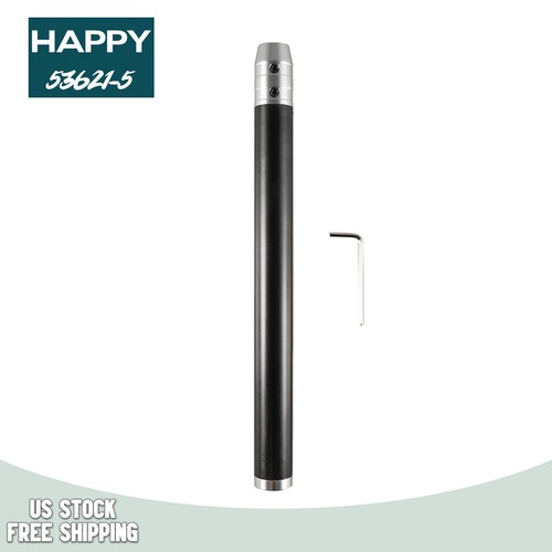

There is some chintzy aluminum handles on fleabay for $9.99. I bought some for my Chinese carbides. They work and haven't broke yet but they are very lightweight and not the longest. 12mm hole I think.
If I were to use them more I would probably put some bb's in them and maybe wrap with something to make them larger in diameter.
Or there's this route---- https://www.ebay.com/itm/1246396086...639608637|ni_bn:1&_trksid=p2380424.m570.l5997
That is high dollars. You can get a complete Thompson handle for about the same $$. A 12” X 1 1/4” aluminum bar is about $20 and you can make 4 from that.
Pretty sure that is for the set of three for $51. Singles from this guy are $18.90 . Drozda adapters are $22 a piece.
Still pricey and then you have to make the handle on top of that.
I still like the Thompson handles because they don't roll. What's he do, buy bigger tubing then mill the flats on it I wonder?
