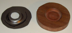

This is a long ago picture of ipe wood turned on the lathe used as a die to hydraulic press form 18 ga steel using 50 tons force. Usually dies like this were made of aluminum, but ipe proved to be strong enough.
I got a bunch ipe left over from a deck job so the price was right.
The pictured item is part of classic car restoration needing a new headlight assembly. From memory the part was about 8" diameter.
