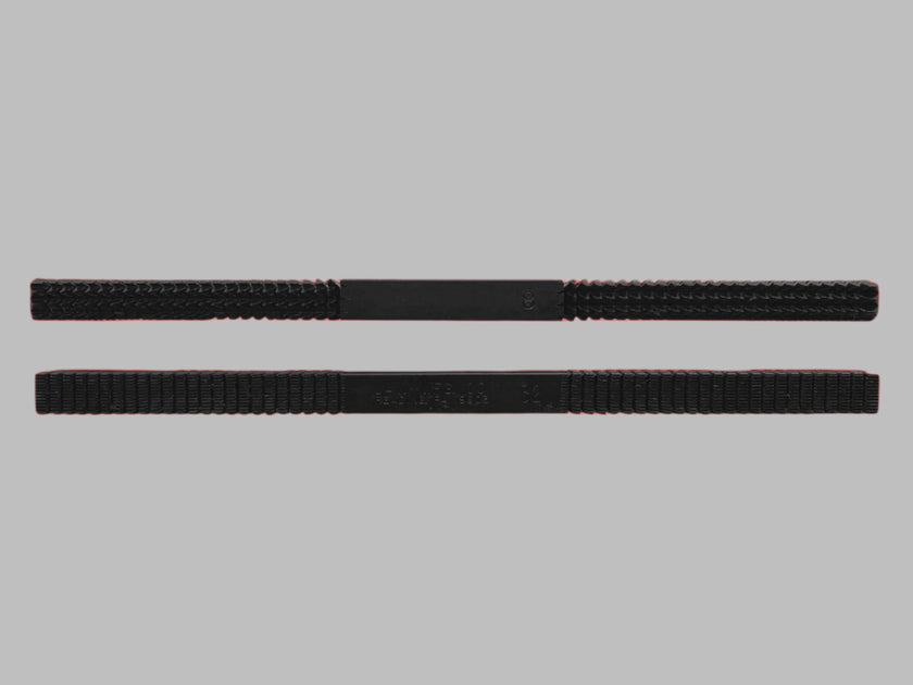

The treads can easily be repaired. Here's an off-shore clone of thr tool I have've used many times to repair thread damage. Provided your spindle is 1-1/4" diameter or less and are an inch series thread like 8 tpi its an easy job.

I have used tread repair files, they are not that expensive and easy to use, they will repair treads to their original shape.
Here is one that gives you 8 different threads it will repair, there are several places that sell these files, just make sure it is for steel and has the 8 TPI it will repair.
Triangular filed are not going to do the repair, it ca file some spots that are damaged, not whole threads

I've got lots of thread files and they often work well on more threads, but 8 TPI may be a little much. I think a die would be more predictable for such a short threading length.
