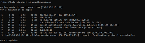

day 3 and still can't connect. tried changing DNS servers but still getting "site can't be reached" error . ran a ping to www.thewows.com ( It pinged 38.65.96.131) and got "destination port not reachable" can someone help me and run a ping and let me know what happens?
That means that have ICMP turned off for responding to pings. That IP is resolving correctly, so it isn't a DNS issue. If you open up developer tools in the browser (Ctrl+Shift+I , or just right click and "Inspect" some element) perhaps there is some information the console tab?
thanks but console tab has "no issues" besides it's happening on three different windows computers on both chrome and edge and also on my chromebook! I am stumped and missing The WOWS! I'm going to take my laptop to another location and try it

Instead of pinging, try a Trace Route (command on windows is tracert). Trace to the domain name, and see if it is able to reach and identify all the intermediate nodes between you and the server. You may have a routing issue. Can be caused by a number of things, but it might take a call to your ISP to see if it is something they can resolve. If your tracert works, it is also possible that a DNS update is taking a while and you are one of the outer nodes that have not been updated yet. Usually that happens fairly fast, but for the servers farthest from the source that can take a couple of days, although in rare cases it could take longer.

John, thanks for the suggestion. I've never used tracert before so I gave it a shot. see attached for the results1752640416155.png

John, thanks for the suggestion. I've never used tracert before so I gave it a shot. see attached for the resultsView attachment 77488
That last one indicates a problem. Kind of an odd one, protocol unreachable. Usually it's host or port unreachable. Could mean a couple of things... First is that your ip may be blocked at the server. You might try reaching out to your isp and see if they can force a new ip address on you. Then see in you can connect.
Or could be they are just blocking ICMP Echo requests (possibly part of a DDOS prevention) If you'd tried tracert yourself, likely would have gotten the same response (I just did)
However, if you were using Linux command line you could specify the port to make the request (can't do that on windows tracert) so more likely get a valid response from port 443 (https:)
But other than that, he could well have had his IP address blocked by the server's firewall for some odd reason (Could be his computer glitched on some sort of request and the firewall pre-emptively blocked what might have been seen as a precursor to a DDoS - It's very rare but has been known to happen depending on firewall configuration - in which case the server admin simply would need to restart firewall, though it may itself be on a scheduled task to restart weekly or monthly)

IPs also float around from user to user over time, when they are dynamically assigned. Its possible his IP was up to malicious activity in the past, ended up blocked, and then was assigned to him recently, and he is suffering from a past block.
In any case, it is worth trying to get a new IP and see if that helps. I had an IP that was blacklisted from the Lowes web site, and for a number of sites through CloudFlare. I had to get a new IP to get past the inability to visit those sites.
just got back from McDonalds, a few miles from home. Got to thewow's site, no problem. Called my ISP and they didn't have any tools to trouble shoot but from thewows site he gave me the name and phone number of their technology partner, webenology. tried to get to their site and got the same error message!. but my ISP also gave me a phone number so I talked to a tech. He was driving but I texted him my current IP and he is working it.
Just tried to get into THEWOWS and looks like this problem is back. although this time I can get to their web partner, webenology. Last time they had a block that filtered out my ip. Will try tomorrow and call them again it it's still a problem.

Hey Dave, thanks for posting. I don't see any problems on WoW's side, so it must be another issue from your local ISP. Frustrating, I'm sure. How's everything looking today?
