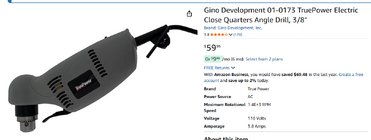

Roger, I did the same thing. Went to HF to get their drill until I could find a good deal on a milwaukee on Ebay. That was 5yrs ago. Still using the HF drill. I know they get bashed alot in forums. But its been working well for me. You could also pay for their extended warranty. Then all you do is take it back and get a new one. I paid for the warranty but haven't had to use it yet. (knock on wood)
My last purchase was the HF angle drill. So far, so good. On the other side of the scale, here is a drill you SHOULD NOT buy on Amazon. I had two and they both failed within 2-3 months.
Kent, thanks for the heads up. I've been looking at options on Amazon.
