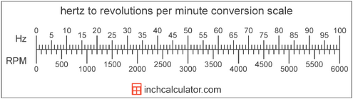

I think the frequency would be a bigger problem than the voltage.
yes in Australia its 50hertz unlike the USA 60 hertz. Transformer, 5000watts seems a bit high unless you bought many 240v tools, with the 60hertz it might a bit hotter and certainly faster. All the Arbotec gear I have is designed to run on the standard 4" portable grinder. I see that there three power tools listed in the bundle, it might be a good idea to looking into that side of it as grinders are quite cheap.
