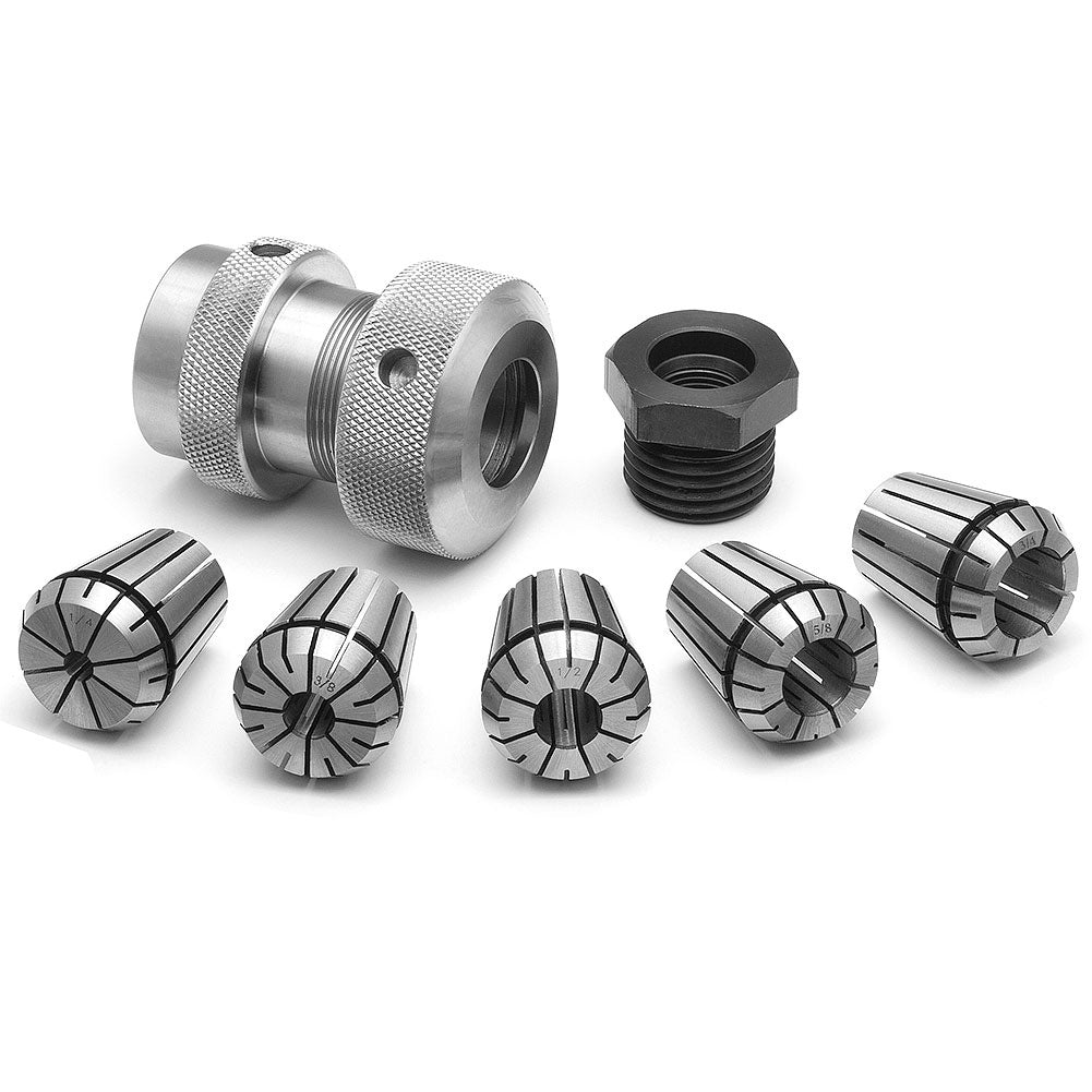

Just as an aside, I use collet chucks on my lathe for turning small stuff. I just make shafts to suit, or just use threaded rod.
