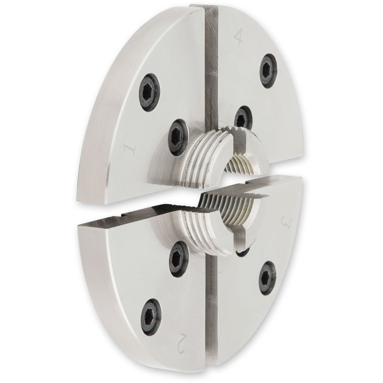

My straight tenon is no longer than your dovetail. Even though it's shown that way in the ad picture. The serrations on the gripper jaws are relatively small. Not like the hollow forms jaws that have a long tenon.
Maybe I'm doing it wrong, but it works for me so far. I just bought this set "BF" and am finding it really handy for some small stuff I'm working on.
