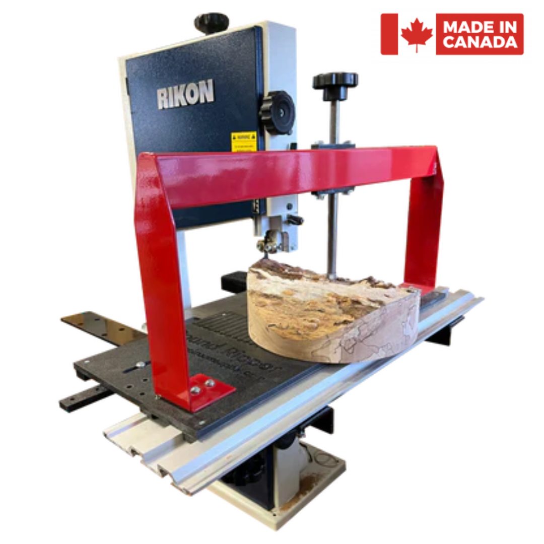

Thank you everyone for all the great answers! I also purchased a a gizmo similar to what Gerald shows above, but commercially made , really well made, retails for about $399. Got it for $100. I also got a box with over $500 worth of carbide blades, all types of sizes... I will take a picture of the sled looking apparatus tomorrow. I have read every post here, every answer and advice, carefully. I think I have "The Bandsaw Book", time to read it again... A friend showed me how he marks a "danger" zone area with a sharpie, on the table of the bandsaw, means keep your hands out of here... Thank you to club member Wayne Omura for the help moving the saw. Wayne got a giant Powermatic and a drum sander today too... Aloha

Carter makes a carriage that is adjustable for cross cutting round stock like logs. I think it runs about a hundred dollars and is adjustable.

Hi Emiliano,
The sled is from Stockroom supplies.
View: https://www.youtube.com/watch?v=TctAz6l7MHA
They have great customer service, some wonderful videos (YouTube?) and a very cool device. I have one if you need Pics, but probably better quality on the web site.
