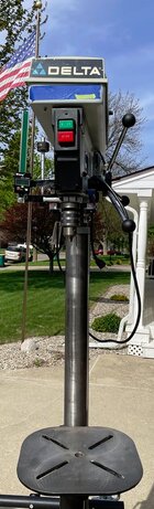

I was able to pay $1,200 for multiple items from an estate auction. Included in that price is a duplicator/lathe, a vertical/horizontal Jet bandsaw, a Dremel scroll saw on a stand, a Delta drill press, and sharpening station, as well as several other items. Pics attached.

I am trying to locate some parts for it. It works fine, but I need a tool rest. The issue is the tool rest is 1 1/4" diameter. I have tried the local Rockler and searching the internet, but unable to locate one. I did insert a brass bushing and reamed it to the right size, but I would prefer the correct tool rest. I would love to be able to use this, but would like it correct. Would also like to explore different chucks for it, but again, metric and I can find nothing as big as it needs to be. I have an antique Craftsman drill press, but this one is in better condition and has lasers to help align the work. I was using a new benchtop drill press, but found it was too short when drilling blanks. I gave that to another woodworker in the area. I am very happy with the band saw. My old was a Ryobi and I cannot give it away even though it works well. This one opens more options for use. Overall I am extremely happy with my purchases, but would love to get the big lathe (approx 6' long) into production.
