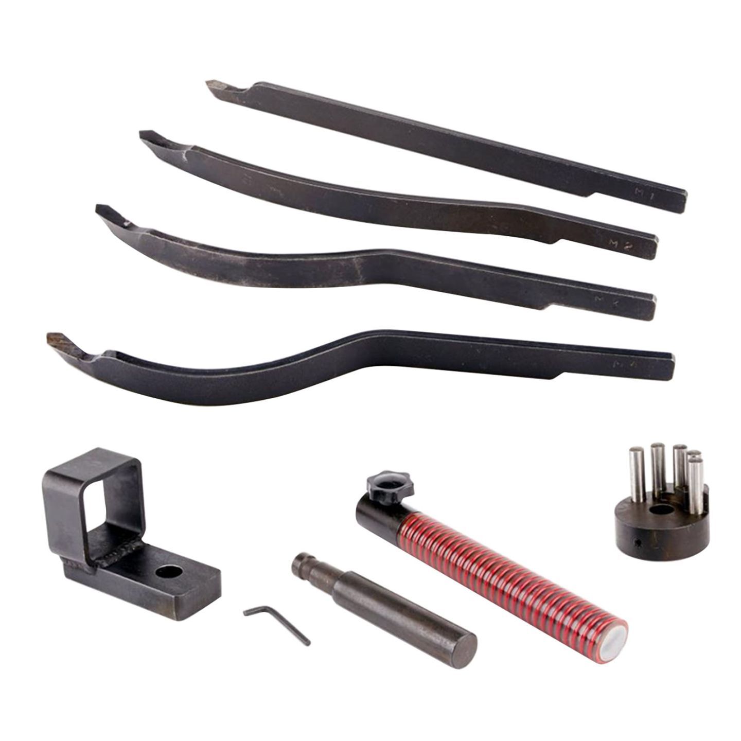

Bowl Saver System

I had all 3 coring systems, I had the original Woodcut and it works just fine, it does what you want it saves chips on the floor. It was my second favorite. The Oneway in my opinion is by far and away the best of the three and is the one I kept and it is a lot more versatile than it is given credit for.
I do have the old 2 blade Woodcut coring system, and the newer 3 blade system. I would opt for the 3 blade system since it does have a larger blade, in response to customer requests. The thing I don't like about it is that you need the tailstock on the lathe, and for bowl turning, I don't have it on the lathe most of the time, well never really.... The Oneway coring system is nice, but the factory cutting tip, to me, gets worst design ever. Many have opted for the Core Pro from Hunter tools. I prefer the McNaughton, but there is a "learning curve"....
I’ve had the 2 blade version for ~ 6 yrs. Works well. If you plan to core larger bowls, the 3 blade would be the choice. It has a lot of flexibility to bowl shape, depending on how things are lined up and which blade is used. Also, thicker walls can be cut allowing for more shape change. Easy to set up and use. I made a laser pointer device similar to the one Woodcut sells, and it makes set up much easier than the templates.

I had the bowl saver two blade version and found it to work very well. The only problem was that the largest core was not as large as I would have liked. It did however make a more useable smallest core than the Oneway does. If you have a lathe that is 16” or smaller it is a grate choice.

I've had both the Woodcut and the Kelton corers, acquiring them in that order. Once I 'mastered' the Kelton I passed the Woodcut along. No complaint about the Woodcut, but it does need to be used inboard with the tailstock and that may suit many turners, but I do all of my bowl and hollow form work outboard and prefer to work in that position.
There is newer version of the Woodcut, so I can't comment on that, but I found the Kelton with the full set of bars (yes all of them!) to be more versatile for my purposes.
However, the full set of Kelton bars is a large investment that I had to give careful consideration to in terms of just how much value I would get from them over their and my life cycle... 🤔 ...so far they and I are are still going and I'm well ahead on my return on investment.
My suggestion to anyone who is considering a coring system is to try them all out somewhere before they buy, ideally with someone who is a proficient user.
Also, the Kelton straight bars that come with each set of bars have been of no use to me, but ended up with multiples of them in different lengths. If you can buy the curved bars individually, a few at a time, that would be the way I would go.

The McNaughton is the easiest to set up followed by the Woodcut and lastly the Oneway. The Oneway weighs about 5 or 6 times more than the McNaughton and at least twice that of the Woodcut. The main thing for me was How I felt using each system. I felt and still feel very safe using the Oneway and basically the same using the Woodcut. I never felt safe while using the McNaughton with their narrow light weight shafts with very little support in the cut and it scared me. When you don't feel safe using something you are not going to use it and that was why the McNaughton was the first to go. Now I cored many pieces with the Woodcut but I also had the Oneway and you really do not need two coring systems so I passed on the Woodcut to a friend which is still being used today. If you are asking why did he have all three systems it was because I was writing articles and I was going to do an article on the three of them but someone beat me to it. I have now upgraded the Oneway with the handles that Glenn Lucas sells which does speed up the use of it and not to mention the Korpro that makes the Oneway a real smooth and fast coring machine with the ability to make as many a nested set as the McNaughton. Use what works for you.

I have used both the McNaughton and the Oneway. I first used the McNaughton and had similar experiences as @Bill Blasic, and could never get consistent results with it. I now use the Oneway in the following fashion so as to minimize setup time. I will rough out and put tenons on the exterior of multiple blanks before setting up the Oneway. After each blank is roughed out, I put it in a heap of shavings to keep it moist. After all the blanks are roughed out, I then mount the Oneway base, and proceed with coring each blank. This way I only have to mount the Oneway once when coring multiple blanks. I guess you could call it batch processing, and it saves alot of time.
Some one once said, about the McNaughton, "I am either 2 inches too deep, or 2 inches too shallow". Been there, done that, more than once! They did make a laser pointer thing for the McNaughton, and I had it on once upon a time, but you had to use the set screws that secured the blade to the handle to mount it. I think I had that bracket tac welded to the handle. It is a bit inconvenient to say the least. Saw one turner who used pencil lines on the outside of the bowl to mark where he wanted to end up. That does seem like a good idea for some one who is learning to use this system. It used to take ma about 45 to 50 minutes to set up, core, and turn a 3 to 4 bowl set. Doubt I could do it that fast any more. There were some who claimed that coring reduced shaving build up on the floor. I don't think so, you do save a LOT of time when you core. I do have a video up about coring with this tool. Old one, but it still works. Maybe some day, I will do a review on all 3 systems.
