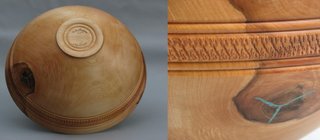

I have never turned beads on green wood. Have not done many lately but for several years used a combination of Point Tool for beads on the outer surface and either Sobey Texturing or Spiraling Tool effect between two beads. Also use one or two beads on the bottom,, depending on bowl size and sign and identify inside the bead. Also one with just a simple bead near the rim.
