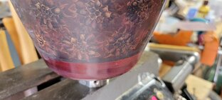

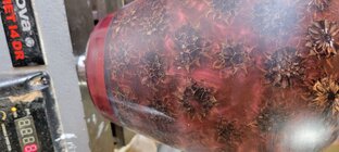

I need some real help here.
I will try not to ramble on too long with my issue.
I am about a year and a half into wood, turning now and about three months into resin work. I have turned a couple of pretty nice things but as always, my issue is the finish. I did the obligatory, sweet gum pods in resin and I cannot for anything get a real transparent shiny finish on this vase. The surface is smooth as glass and i'm very happy with it but it just does not pop at all. It's very dull. I have tried Maguire's polishes. I have tried the Mohawk high gloss buffing compound with a handheld polisher, and what I think are the appropriate buffing wheels, but still no dice.
I am definitely an advocate of the handheld polisher versus putting it on the lathe (buffing wheels, etc.). No matter what I do, though, the finish always ends up kind of dull and almost cloudy. What am I doing wrong?

I see what appears to be a lot of scratches, tell me about how yyou are sanding, what type of paper, what grits, then tell me how you are using the mowhawk or maquires.
The amount of gloss you will achieve is directly related to how well and how high of a grit you sand too.
I agree, there looks to be quite a few scratches. I have 4 suggestions that may or not be necessary but might be helpful. I don't have much experience specifically with resin, but most of the videos of epoxy river tables that I have watched put a top coat like varnish, hardwax oil, etc on the resin. I would consider wet sanding of the resin (with water) for grits 600 and finer. Next, I am not sure why you would so readily dismiss buffing wheels on the lathe; I am quite happy with the Beall system. Buffing a piece sanded to 400 grit definitely produces a glossy sheen, on both wood and epoxy inlays. A similar effect to buffing is a sanding paste, like Yorkshire Grit. Many turners use these pastes instead of sanding to the highest grits.
You definitely need to sand through each grit being sure to sand out all the scratches from the previous grit. With resin for a high gloss you really need something like Micromesh, wet sanding through each of its grit to its highest grit. Only then will the Meguires do its job. Try to avoid overusing the dry sandpaper, the grit breaks down and gets irregular then you tend to push it too hard and gouge the surface.

For resin I like to dry sand up to 400 grit then switch to silicone carbide paper and wet sand to 3000. Then I switch to micro mesh and go all the way to the finest grit wet sanding. Then its blue rouge on a cotton wheel followed by a clean cotton wheel to remove residue. Once you get past 4000 on the micro mesh it will start to get transparent.

Thank you all for your valuable input. I'll digest all of the comments and take another shot at it. For what it matters, I'm using SuperClear Deep Pour Epoxy Resin in the project.
