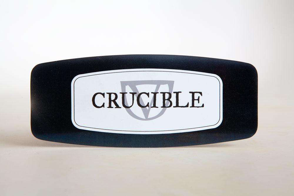

Here is a wonderful USA-made card scraper, costs all of $24, and I have one. A nice 8-minute video at the bottom of the page shows how to dress and sharpen it, too (their preferred method, anyway, but you'll get the idea). They sell the carbide burnisher shown as well.
Other tools from them are also available. Lost Art Press is also a woodworking book publisher (50-60 titles) Furniture is the general focus, but the books are high quality in both subject matter and construction. I own several of their books and a handful of their tools, all first-rate stuff.
Lost Art has some turning content also; they have a video you can buy from Peter Galbert on spindle turning which I keep meaning to get.
