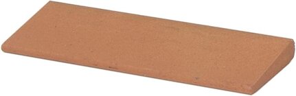

Where did you get the tear drop hone?
Can't say I have heard of a tear drop hone. DMT makes a lot of diamond sharpening plates, and Sharpening Supplies has a lot of things too. Some of the big box stores have diamond plates. I think their "fine" grit is 600. I do have small ones, maybe 3 or 4 inches of diamond and it closes up like a pocket knife.
Okay.... When I hear "tear drop" I think of the cutters for inside hollow forms. So, does that one have a rounded portion for like the inside of your flutes? the one I have is more like one of those butterfly knives.
