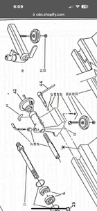

So is the hand wheel itself stuck or the quill. The only things I see on the diagram are a pin driven from the bottom, the locking lever, and a keeper plate that goes through the housing into the slot in the hand wheel.
The keyway on the tailstock quill can sometimes develop a burr especially after a lot of use with inadequate lubrication or cranking the handwheel while the quill is locked. I had this problem on a Delta lathe. I chamfered the edges of the keyway after I finally got the quilt out.
Matt: The handwheel is totally locked, and won't budge. As such, I can't manipulate the quill at all. Does that answer your Q's? Should I include other photos of the entire tailstock Assy? And thanks for trying to help!
I'd like to see the exploded view of the parts diagram, along with the relevant part of the parts list, if that's no too much trouble. It would be interesting to compare to the tailstocks I've worked on.
It looks to me like the quill has moved too far towards the hand wheel side of the housing. The slot in the hand wheel should line up with the slot in the top of the housing. Also in the diagram it shows the quill being installed from opposite side of the hand wheel. Maybe the quill has become bound on the pin in front or the plate.
Thanks Bill. I'll check that once I can finish banging the quill out of its current prison.
The diagram helps a lot. If part 43 is missing or if it came out and was put back incorrectly that could be the problem. Never saw one made that way.
Since the threads are visible at the handwheel you could see if they have left or right hand treads.
If the three parts Matt mentioned are removed the fix might be straightforward.

Chris it looks like the pin sheared off from the hand wheel being over tightened which caused that vertical groove in the last picture. You need the pin there as that is what the key way fits over. Just take a punch and knock the pin out, clean the burrs out of the bore and quill. You should be able to find a roll pin at any hardware store fit. As for your hand wheel, hold the quill in a vise with v-blocks or wood. Heat the hand wheel and try to loosen with a big pair of channel locks or pipe wrench.
Matt - Keeping in mind I’m a novice in lathes and terminology… You feel the vertical quill groove shouldn’t actually be present? And is the “keyway” the slot that’s present in the full length of the quill?
By “burrs on the bore and quill”, do you mean “any” disruptions in the smooth surfaces of each? And is the “bore” the inner surface of the tailstock housing? How best to do the deburring?
Should I ask the hardware store for a “roll pin”, by that name (new term to me)? Should the new roll pin protrude fully into the depth of the keyway groove?
