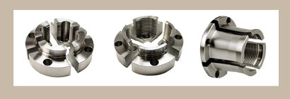

I have been watching a lot of Richard Raffan and he often uses what he refers to as shark jaws which are very versatile. I have searched most of the chuck manufacturers and can't find that type jaw. All of my chucks and jaws are Nova.I have searched their website and also Record Power as I understand will they fit Nova Chucks also. Any suggestions from the forum.
This is a link to the vicmarc shark jaws. They are tall serrated jaws with a dovetail at the top.
You might find similar jaws with other manufacturers called tower jaws. ONEWAY has a series of these
These are the Teknatool Nova internally "serrated" jaws I use the most. Grip squares and rounds, mostly for various spindle turnings.
They have dovetails on the outside, unlike the Nova Greenwood jaw set.
I have very similar ones to numbers two and three in your picture, very useful. They are supplied by a company over here called Charnwood and fit Record Power and Nova Chucks.
Edit: I’ve just looked at a RR YouTube video and he calls these Shark Jaws and they’re mounted on a Vicmarc 100 Chuck.
I’ve seen these called Ripple Jaws by other companies.

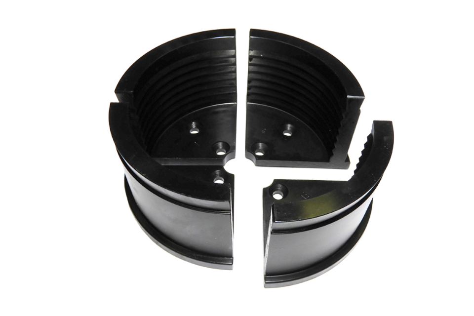

I decided to buy a set of these Axminster Jaws, they are much bigger than I expected and weigh just under 1.5 Kg! Very solidly built in Stainless Steel.
I’ll be using them with my SK100 but are pictured here with my Axminster GK88.
Deep outside ripple jaws might be useful for remounting hollow forms with a suitable size opening?
I have a couple of sets of grippers jaws in different sizes and they’re quite sharp, which is good for initial turning. For remounting though, using plenty of packing like router matt, the ripple or shark jaws might be a good option?
