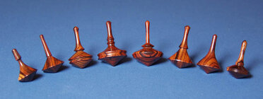

I took this picture in 2008. I gave one away, the other has not darkened significantly in 17 years. Shellac finish.

I made this during the fidget spinner craze in 2017. Still looks the same today. From a piece of the same Cocobolo, Gaboon Ebony, and brass, shellac finish.
