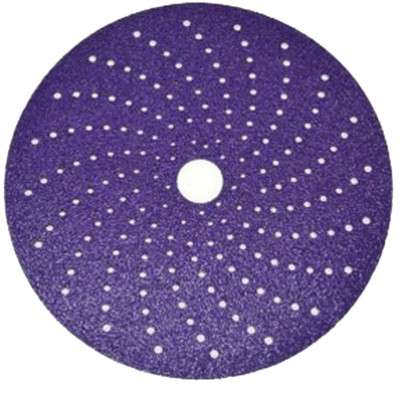

The "Xtract" Cubitron II discs (710W) are on a mesh base. This base and the herringbone abrasive pattern are optimzied for use on a ROS with constant vacuum dust extraction and shouldn't be assumed to perform well on a typical woodturner's rotary sanding setup. This is especially true given the "fraying edges" issue that results from the mesh base.
The Cubitron II Hookit discs (775L) that Reed is sourcing are on a film backing. They perform exceptionally well on a rotary sander and are cost-competitive because of their high removal rates and long life.

As Gord said, I don't think the mesh backing overhanging a sanding pad would hold up that well sanding the inside of bowls. I've used both it and the film backed 5" discs for hand sanding turnings and the film is more durable. The mesh is better for flat work.
