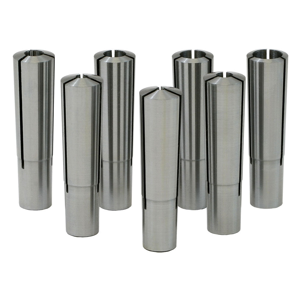

Another option for small diameters is to use #2 Morse Taper collets. They are cheap and hold securely. Mount directly in the taper in the headstock The downsides are they need a drawbar (but easily made for very little cost) and the tenon on the wood needs to be turned to a fairly close diameter. I have a complete set but use only the 1/2" collet for wood (the largest diameter you can get for a #2MT.

For eggs and other special processes the diy approach makes sense, but if you just want to hole smaller shank sizes (long tenon, bolt threads, etc), there are collet chuck systems that aren’t expensive. I have a set similar to the link below - M2 collet chucks, 1/8-1/2”, fit into the HS taper, threaded for std 3/8”, use 3/8” allthred to make a draw bar. They work very well and for <$40 it isn’t worth the frustration of making them. There are other types that thread onto the spindle, place the collet in, then a cap threads onto the housing and pushes the collet in - much more expensive, but they go larger than 1/2”.

See @John K Jordan post #15, the 1st photo. The long cylinder in the photo is a an M2 collet. Slip it in the spindle M2 taper, slip the allthread through the center of the hand wheel all the way until it starts pushing the collet out. Thread the collet onto the allthread. Tighten the nut/hand wheel on the other end of the allthread (in JKJ photo you see a washer and I assume a wheel with a nut in it. The washer and hand wheel are custom selected/made by you to fit your outboard spindle end)
Only take up the slack, insert your tenon (I use the TS to center the other end), and tighten the wheel, which pulls the collet into the m2 taper, tightening it around the tenon. As the tenon is pulled in, advance the TS quill to keep the far end centered.Its an iterative process. The short items like a bottle stopper, the TS may not be needed. I use this setup mainly for long slender finials. Keep asking if you don’t follow.

I love these collets. As mentioned earlier, due to the size of the lathe #2MT socket, a 1/2" collet is the largest available so a 1/2" tenon is the maximum that can be gripped. There are many smaller sizes.
The problem with holding wood in MT collets is the tenon must be turned fairly precisely since the range of grip on these collets is small. Not a BIG problem however, and making fairly precise 1/2" tenons is good spindle practice!!
One huge benefit of using a MT collet with wood is the piece can be removed and remounted precisely, often not possible if the wood is mounted in scroll chuck jaws.
I also use a 3/8" collet to hold Forstner bits that have the 3/8" round shaft. Great for popping into the tailstock and drilling a quick recess to expand a chuck into.
I bought a couple of sets of 2MT collets from Amazon, a set of seven with sizes from 1/8" to 1/2". Unfortunately the price for the set increased from $55 in 2018 to about $89 now. But I see another brand for a lot less. Can't vouch for the quality but high precision for woodworking is probably not needed.
I see Little Machine Shop, where I get many metalworking tools, has them for $80, a tiny bit cheaper (but that doesn't include shipping):
A single 1/2" 2mt collet can be bought for about $15.
