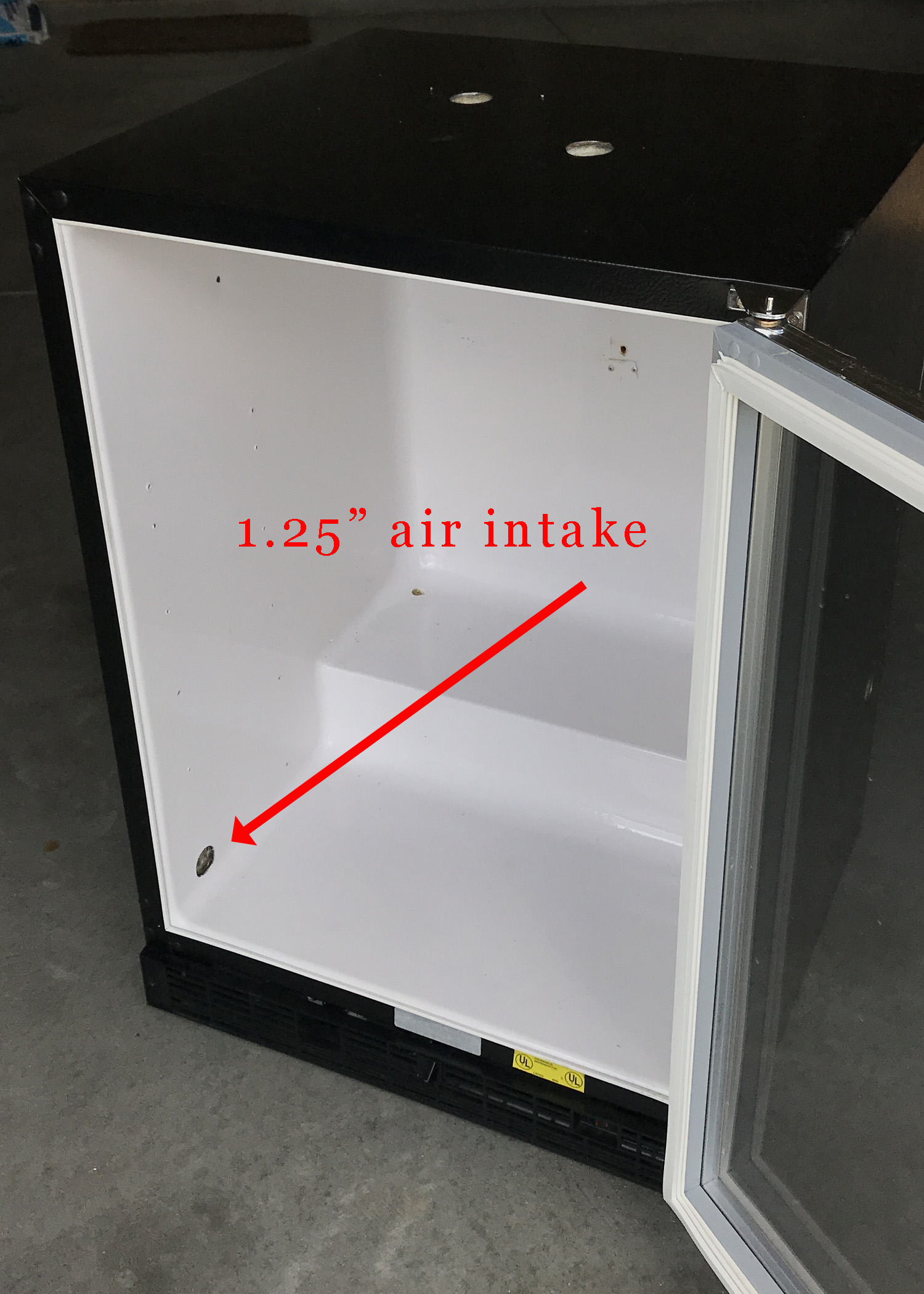

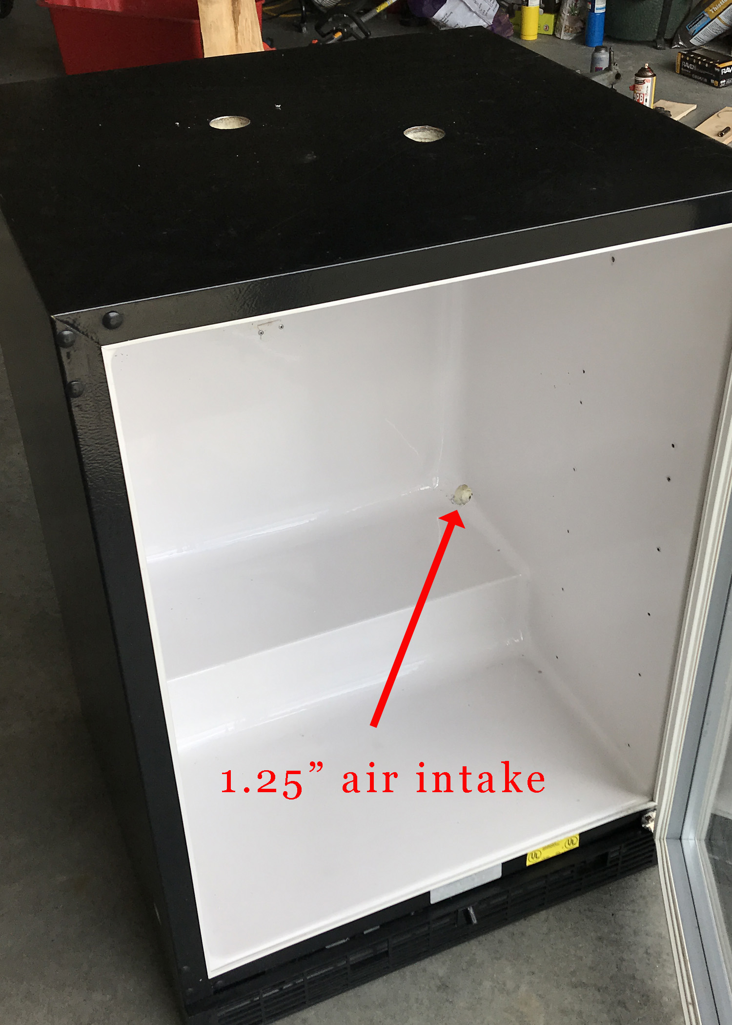

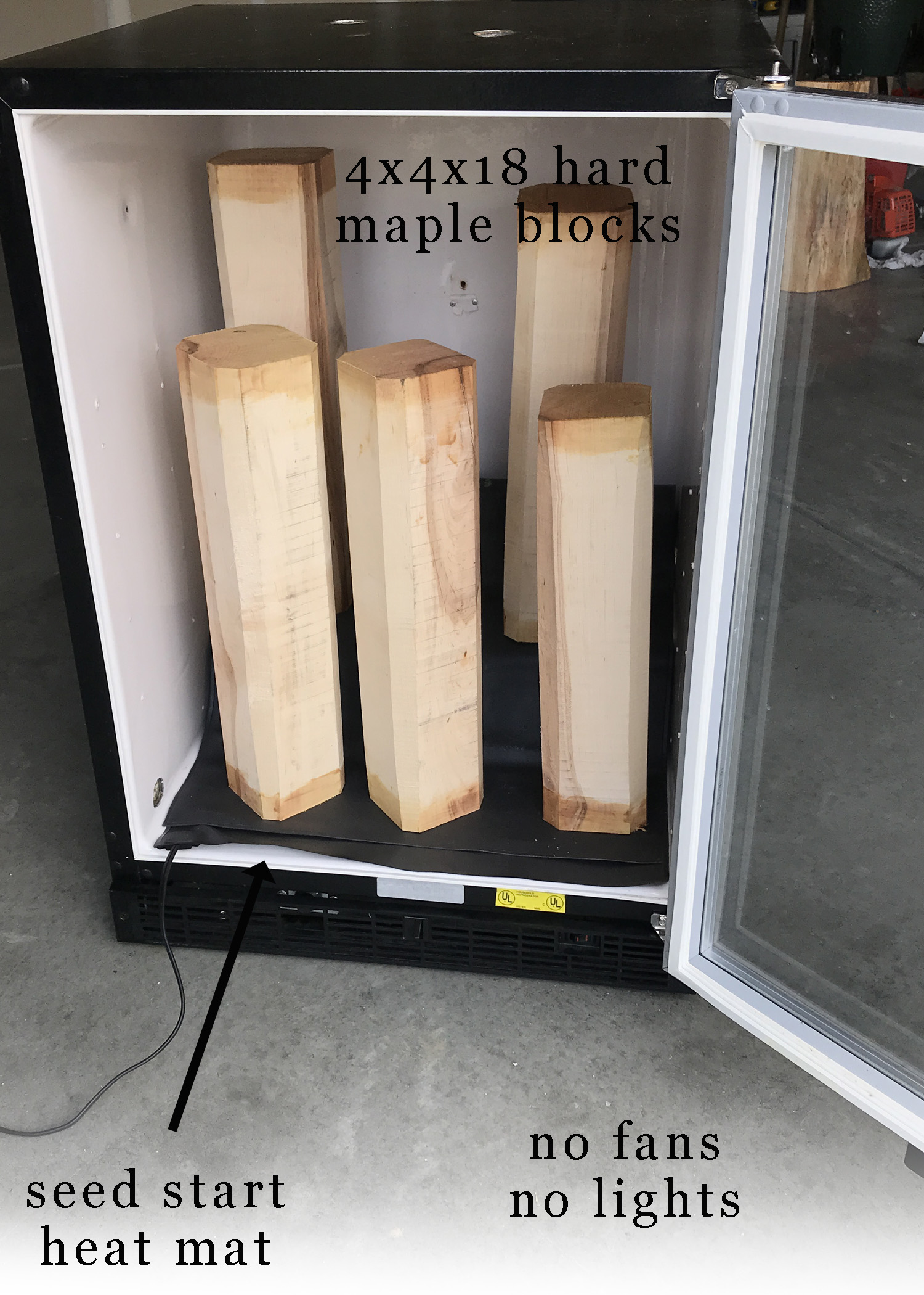

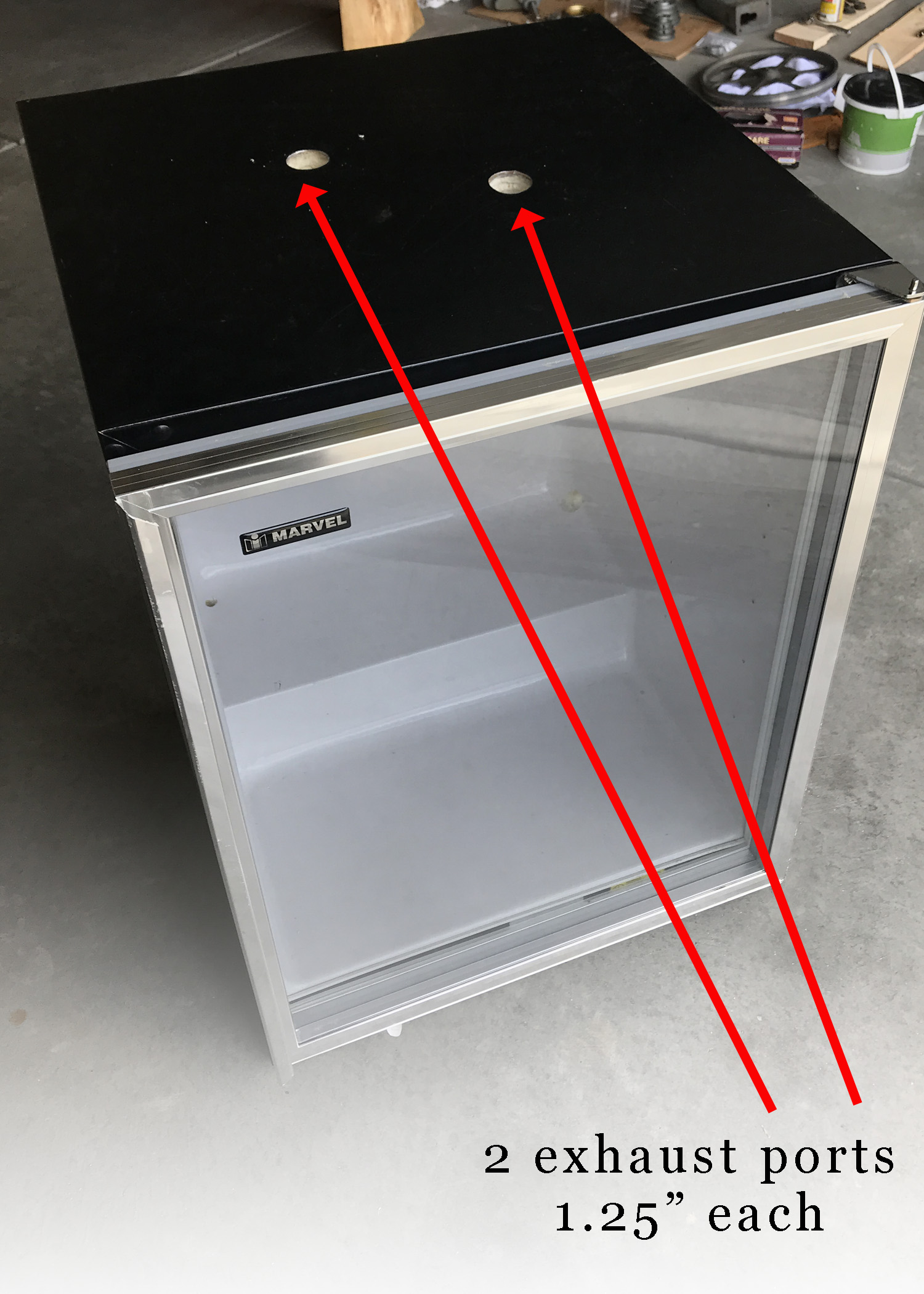

I built my kiln from a free old upright freezer (appliance store). It has shelves. There’s a chase in the back from top to bottom where I installed a fan from a dead microwave oven. A 100 W bulb provides the heat, and it’s only on when temp drops below thermostat setting (105F). Bored holes top and bottom w 2” hole saw. Seems to work, usually quit in about a month.
May 16, 2020
13
2
Mooresville, Indiana
Any thoughts on adding more intake or exhaust holes, if so, where would you suggest they be drilled in the kiln?
The idea is to have natural air move inside the kiln and as the heated air rises it will escape from above and out the exhaust holes.
The air will be heated by the seed start mat that is on the floor of the kiln, the wood will not be placed directly on the mat (as it is in the photo).
Any input on a good thermometer/hygrometer combo would be appreciated too.
