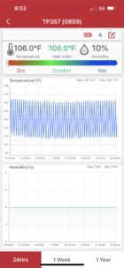

This is the inside showing the bulbs. The fan is also in the bottom.
This shows the controller and switches. The black box is a water heater controller that didn’t work and just left in place. The controller has a thermal probe inside. Separately I have a thermostat inside that provides me the temperature and humidity inside the kiln via bluetooth to my phone.
