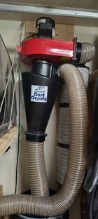

I struggled with dust till I found a Craigslist add for a 1.5hp w/ Oneida cyclone for about the cost of a tank of gas. I run 5" to a big gulp hood and on an mdf backed sanding disc I watch the cyclone of dust get black holed into the hood
