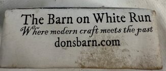

@Jon Rista When I started this thread I knew just about nothing regarding sanding paste. I had seen where some had put a hard finish over sanding paste such as Acks. Since then my google research says Acks, Yorkshire Grit, and EEE UltraShine are basically beeswax, mineral oil and Tripoli. They may also contain proprietary ingredients. I did get a tub of EEE UltraShine at a garage sale. It seems to have a coarser grit than my paste made with diatomaceous earth. EEE’s instructions say to apply over a finish and then use Shellawax liquid or cream over it (friction polish). For now I have limited my application to the inside of boxes. I may venture out and try on turnings with lacquer or poly at some point. For now, I apply Zinsser wax free shellac first and then apply the sanding paste.. Speaking of Shellac wax I also picked up a bar of shellac wax. I really never knew about this, but guess the need do do something with the wax from de-waxed shellac. Says to be the second hardest wax and can be use for filling voids in wood, guessing after the finish is applied.
View attachment 75122 View attachment 75123
So, Acks has two parts. There is the sanding paste, and the "restoring polish", and it is the latter that has oils and waxes. I think its both carnauba and beeswax, but I don't remember the full formula as they haven't included it on their tubs in a while.
I don't think the Acks sanding paste includes any wax. It may contain oil, not sure, but it doesn't feel like it? Its a very different kind of paste from Yorkshire Grit, which DEFINITELY contains wax and oil, and you can feel it. With Acks sanding paste, you can remove it all from your piece, so long as you sealed first. I suspect if it contained wax, that probably wouldn't be possible.
I've actually tried a number of different sanding pastes, including something called True Grit, Yorkshire, this stuff from a guy I found on Etsy, and one batch of some home made stuff. I don't think I've tried the EEE UltraShine... All of those included waxes and oils. I liked the Yorkshire on some things, I didn't really like the rest. Yorkshire is the only, I guess you could call it, "classic" sanding paste" that I use, but most of the time, I use Acks sanding paste and Restoring Polish. There is just something about how it works, that I prefer. I think it may in fact be, that Acks purposely separates the oils and waxes into the "Restoring Polish" and that the sanding paste is something unique.
If you haven't tried it yet, I'd give the Acks Sanding Paste a try. I honestly think it is something fairly unique in the arena of sanding pastes. You can control how shiny your results get, by how fine you sand before sealing, the kind of sealing you do and how thick the seal coat. If you put on a few coats of shellac, and lightly smooth those out first with higher grit sanding, then use the Acks sanding paste, you can get a pretty shiny result if that's what you want. You can also use a single coat of shellac, and get a softer satin sheen.
