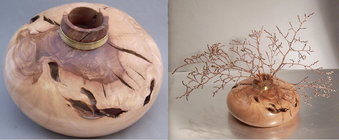

In a word, Daniel, Celebrate!. As a dry-wood, end-grain turner, I routinely violate Msr. Jordan's motto. My mottoes are 1: "It's amazing what comes out of trees" and 2: "It's better the be clearly wrong than unclearly maybe."
I'm still working through the remains of a diseased red maple that I had to fell to build my new shop. The tree was full of internal cracks along the annular growth surfaces so the majority of the milled boards went to the firewood pile, but the turning sections have yielded treasure so long as you don't mind cracks and epoxy.
You do need to inspect and fill the "defects"
Then get it round to see what you've got to work with (here 18"x9"). Then go to work, being mindful to watch for micro-checks you might have missed, and hopefully you come out with something like this

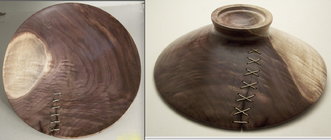

Normally I don't have splits, but sometimes the wood does come with splits in it and is such that I will keep it and turn anyway.
Like this Black Walnut I got and had a split in it, seeing that it had some nice curl I decided to keep and turn it, drilled holes on both sides of the split and then got some brass wire and stitched this, did this in 2006.
