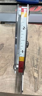

Watched a video on this and of course now I want one. One problem. I can't find one and the guys site says it's out of stock and can't even find a date on any of the sites that used to sell them of when they were sold.
Does anyone have one of these or know where they can be found? Or if they ever come back into stock? Maybe like the elusive oddnot...

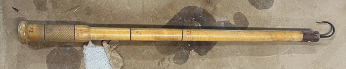

@Sam Fleisher I have one. I use it on spindles. It works very well. It was out of stock when I wanted to buy it and I signed up for a notification when back in stock. It was available about 6 weeks later. I’m guessing you know how it works, for those that don’t you can use it while the lathe is running to see what your diameter is at any time. I don’t know how the Veritas works, but the Galbert works very well.
No; I don’t want to sell it. I will be making about 15 fishing gaffs for my brother starting next week. Three different diameters 1”, 1 3/8”, and 1 7/8” about 24” overall length. It will get a lot of use. Picture is one I made years ago. New ones will be cypress, stainless hook, and brass insert.

I have one, I too put myself on a waiting list as I wanted a metric one. As soon as the metric version was available I received an email, then I ordered one.
Really handy unit, makes quick work of reducing parts of a piece to a required diameter, then one just carries on.
Another use is to check the diameter of anything round on the lathe by just quickly holding the unit against the piece; so quick.

Those direct read calipers are not the same as the Galbert. It's hard to describe how it works, as it's unique. For production spindle turners it's a game changer.

It is really designed for chair makers (by a chair maker). Used for turning stretchers and spindles. One of these days I will make that Windsor chair. I have been using it a lot as it give the actual dimension while the at the is running rather than a spring caliper set to a dimension.

I got one several years ago. At first I thought it to be flimsy and light weight. Light weight it is but it works as advertised. Well designed. I wouldn't want to be without it. Its one of those few gadgets that I take particular care of because I don't want to damage it and be without it. When doing multiple copies of the same profile it's priceless.

The gadget is palm sized and that is nice. Pinch calipers are long and a little awkward but they can have a larger diameter range.
The charm of Galbert's design is that up front reading. Nothing else does that that I know of.
The diameter range is somewhat limited but that range is perfect for most of the spindles I turn.
Before the Galbert, I'd have four or five sets of pinch calipers out set for various important diameters of whatever spindle I was turning. I'd have to mark the calipers for the various detail points. With the Galbert, all I needed was a set of diameter numbers on a drawing or story stick.
