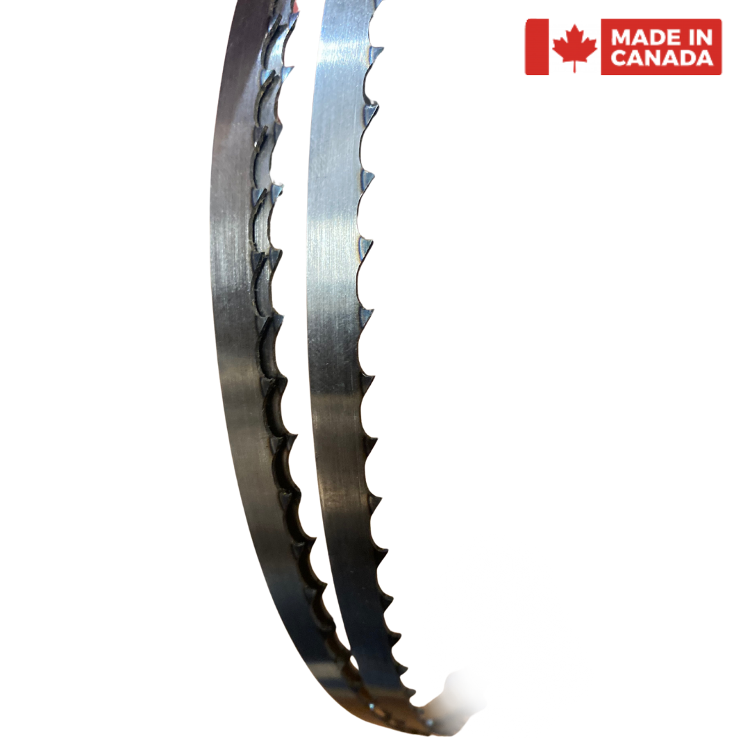

I’ve had really good luck ordering blades from Spectrum Supply. I like the Flexback blades since they are thinner and less likely to fatigue and crack on my small 14” wheels. Hey also sell #32 woodworking blades which are pretty much the same as he highland green wood blades (if you get the raker set) but are a lot cheaper ($15 for my size blade plus shipping)
Spectrum Supply #32 blades
Kent: their website recommends the flex back for under 15’ blades. Mine is about 11’. What tooth config do you use? They’ve got raker, raker skip, raker hook, alt hook. No idea which is best.
I use the flex back 3/8” 3tpi raker hook. Shipping is a little pricey but if you order several at once the savings is significant. And I didn’t have the problems with the band cracking like I did with the highland green wood blades.

...They’ve got raker, raker skip, raker hook, alt hook. No idea which is best.
This discussion of teeth may help. I can't vouch for this web site in particular (just came up in a quick search), but I have seen similar information elsewhere.
What I haven't seen is a retailer/maker where the consumer chooses set and style of the teeth. So it hasn't been much of an issue for me.
