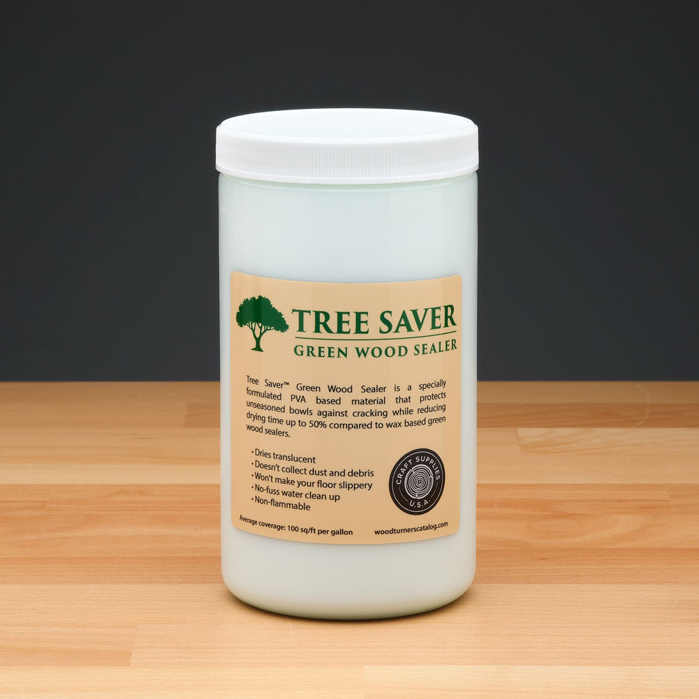

I've been using the Crafts Supplies USA product for over 40 years now, and have had very good success with it. The label has changed a few times, but the white waxy mixture has remained the same. Since a gallon will last me for years, I see no reason to use anything else.
