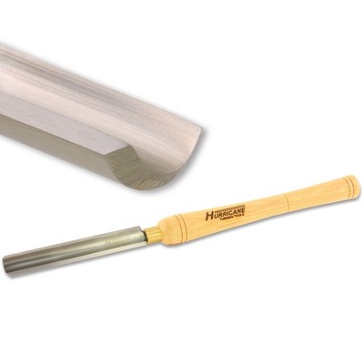

There's more to consider when shopping for low priced gouges than just the steel. The Hurricane tools were an example where the collar of wood around the base of the gouge was so thin that breakage was very possible. (disclaimer: I haven't looked at Hurricane Tools in a couple years, so this may be different, now) Others here on the forum have pointed out that some of the lower priced tools aren't hardened the full length of the tool, so when you get past the first inch or two, you may have 'soft' steel. The flute shape on the lower priced tools, including Benjamin's Best, will be an unknown and may be less than ideal.
