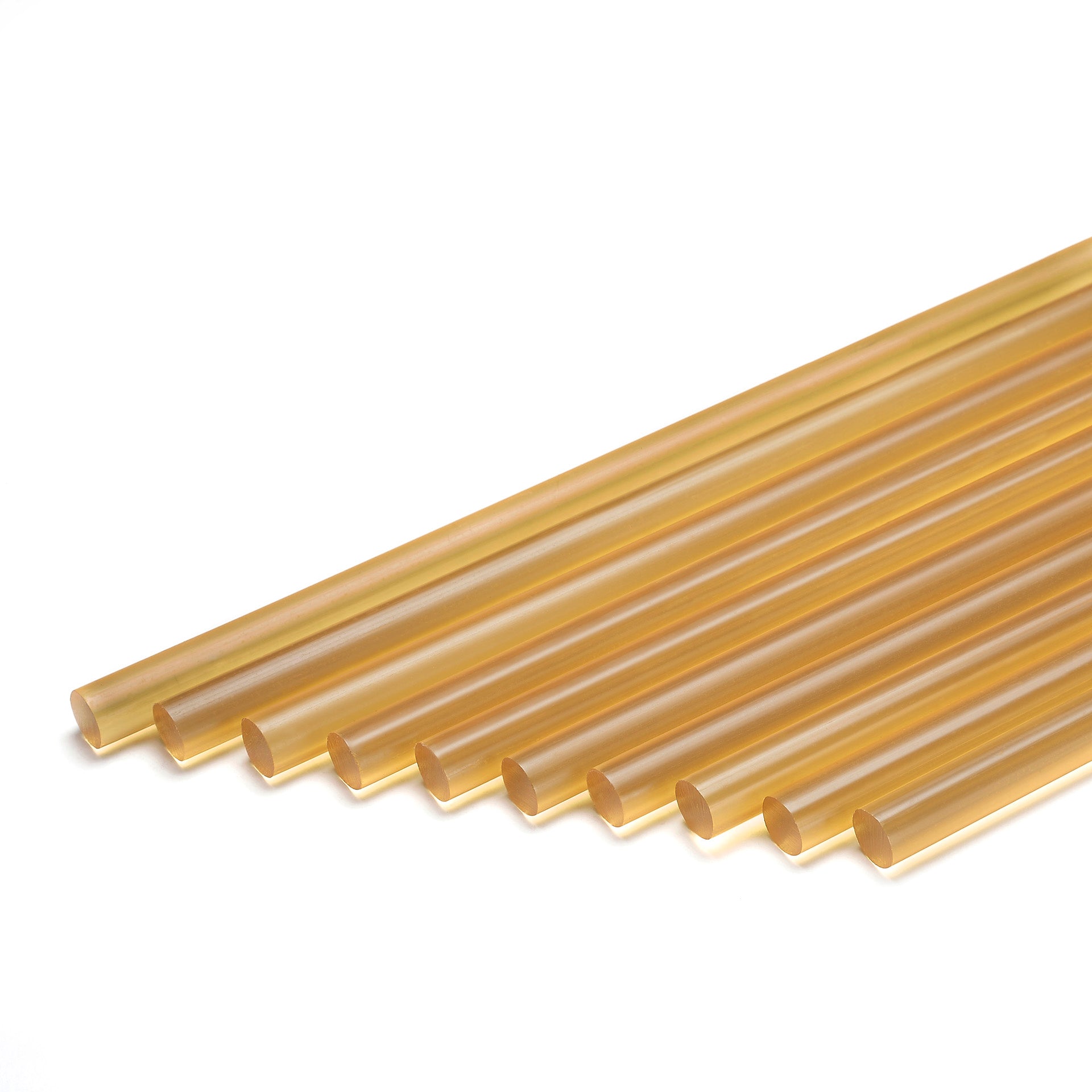

The hot melt glue I have used for various things is too soft when cool to finish. Depends on the cool hardness of that stuff - how well does it sand. The web page makes it sound as though it would cool hard, but no type of hardness value. Also it lists several colors, but the description says there are only 2 colors. If there are 4-5 colors available and thhtere was a sample pack of 1 each it would be worth trying.
Would this compound be similar to that of Bondo type fillers, except heated rather than 2 part mixed? Somebody needs to try it and make a report.
Saw it a while ago at a local wood store, and it is used mostly for the flooring industry. Sounds like it has potential. Think I posted about a month or 4 ago...
I had a good laugh with your line, a month ago, well, maybe 4, LOL. I'm surprised that you saw it and did not pick one up. Yes, we need a report from someone. One from you would be good Robo.
The material is called a polyamide. Nylon is one type of a polyamide. In a youtube video, they use a chisel to remove excess. It appears to have some tear out where it breaks ahead of the pressure from the chisel. So it does appear to be pretty hard. Looks like you need a real high temp gun and kits start at $100.
